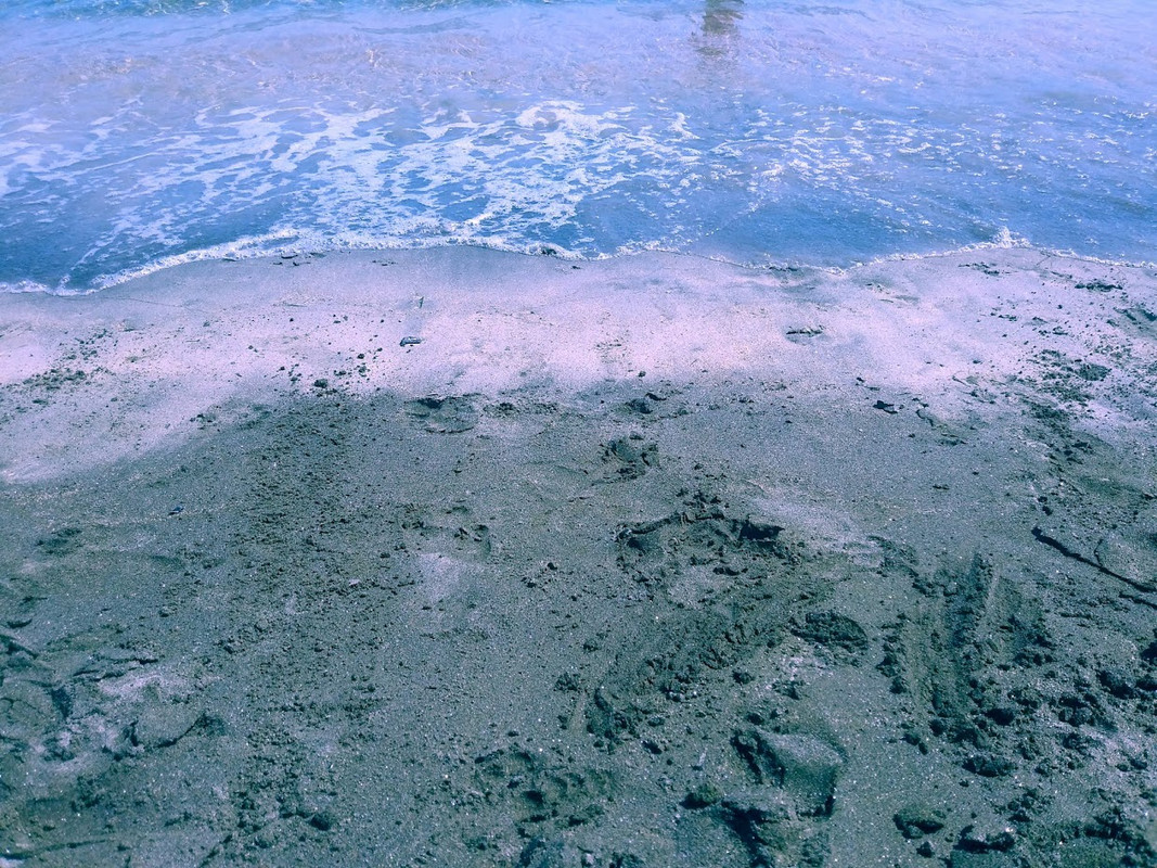

This summer it certainly got more interesting. That is - the first black sand sample gave out almost 60CPS from just a bit less than 50g of material inside the shield (room background being about 120-130CPS). Interestingly, I recently got some apatite from Brazil (about the same mass) - they were thorium-enriched and still had lower activity. So this black sand has higher activity than apatite, which was rather surprising. Ironically, the only photo I took of the black sand "in situ" was exactly from the location I took the sample - at a beach near the town of Sarti:
Normally, the black sand is localized at relatively small spots close to or in contact with seawater and forms thin layers, I guess the sea somewhat sorts the heavy minerals in a "mechanical" way. This one in particular was quite a large spot, with a relatively thick layer and had that dark-greenish color. I was suspecting that might be interesting, because....well, it looked somewhat different.

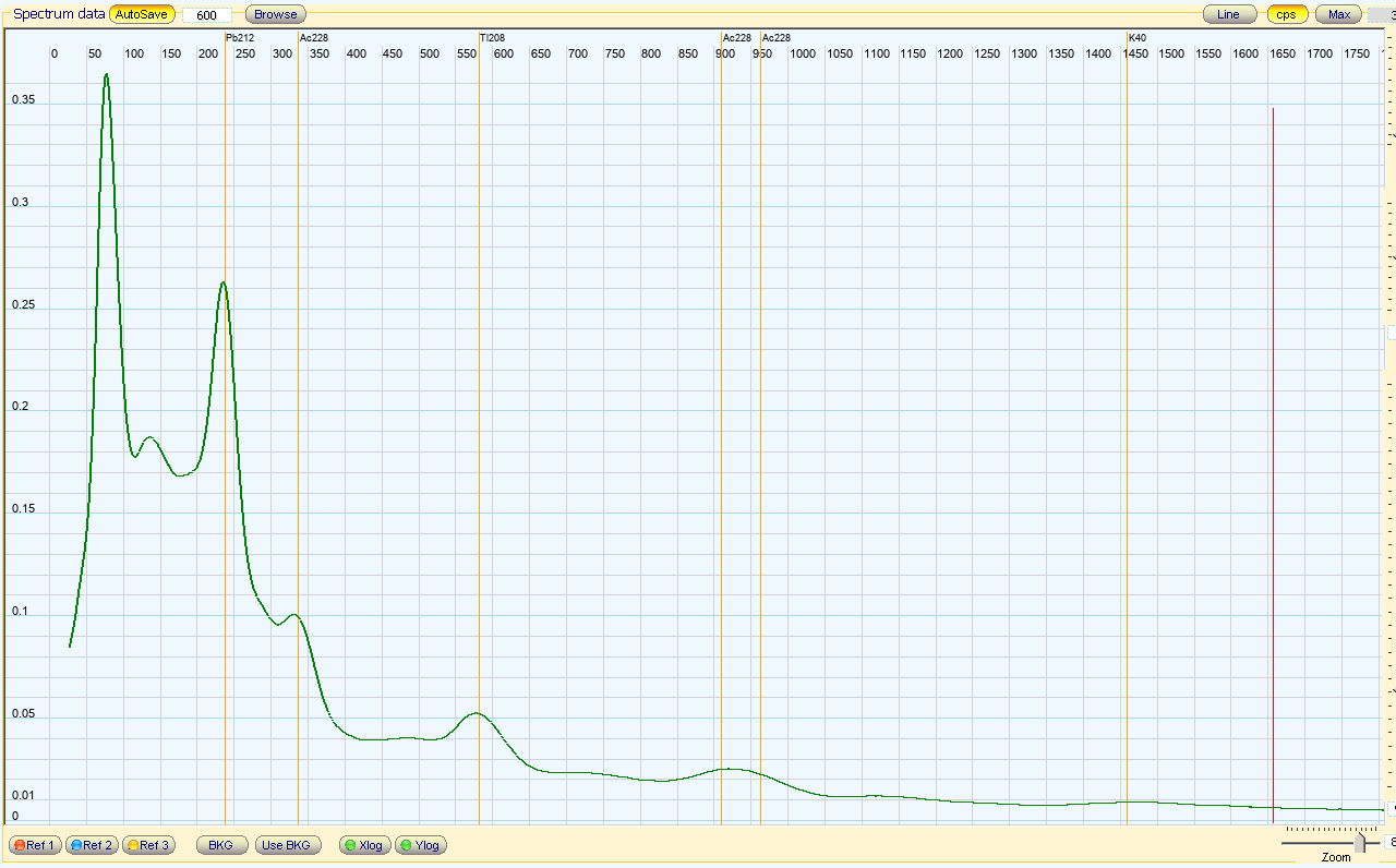

So the spectrum turned out to be a typical Thorium one:
Due to it's relatively high activity, it didn't require neither background extraction, nor a particularily long measurement time, just a couple of hours were quite enough.
Compared to the sand I previously tested from Vromos bay, Bulgaria (where a poorly recultivated copper mine was to blame), that one has like 4 times higher gamma activity. The Vromos sand though was Uranium-enriched, while this one is natural and Thorium and unlike Vromos where practically all the sand is like that, the Sithonian thorium sand is localized in a small spots near the water.
